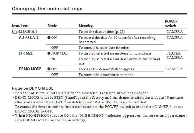

Thank you for your reply and some posative news. By leaving the tape holder open it did leave it in record mode BUT it also sent it into demo mode. Now if only I can find a way of turning off demo mode when the tape holder is left open! Again thanks for your response and if you have any more suggestions would love to hear them.
I don't know this camera model but have you tried turning Demo Mode off in the Settings?
