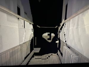

  • Some games, for example Outlast, have graphics artifacts in shadows.

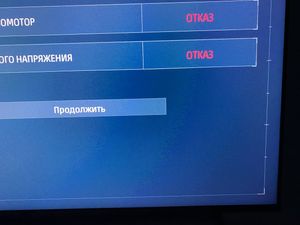

HDMI modes:
Game Outlast has graphics artifacts:

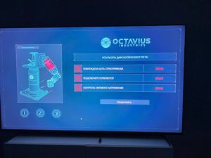

Broken color depth:
