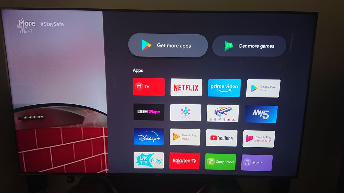

Also picture of the apps view from the apps button
The catch up apps are the sideloaded versions so don't re activate youview
However there is still a risk someone else in your household will scroll down to sony select and use the youview linked version of the app in the row, but makes it much less likely
