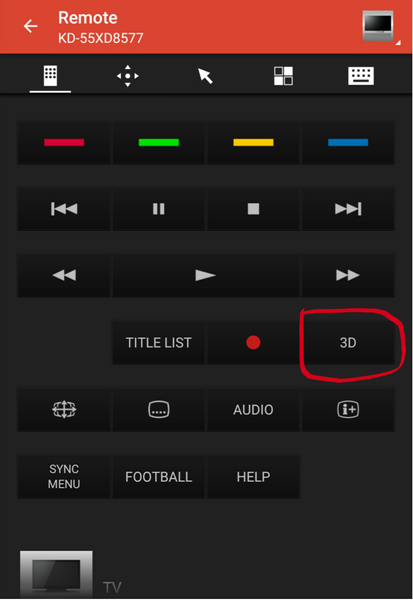

craig.becerril wrote:No luck using the side view android app, since it only has the buttons on the real remote (no 3d button).
Hi there
Welcome to the Community.
Just double checked Sideview app, the 3D button is there:
