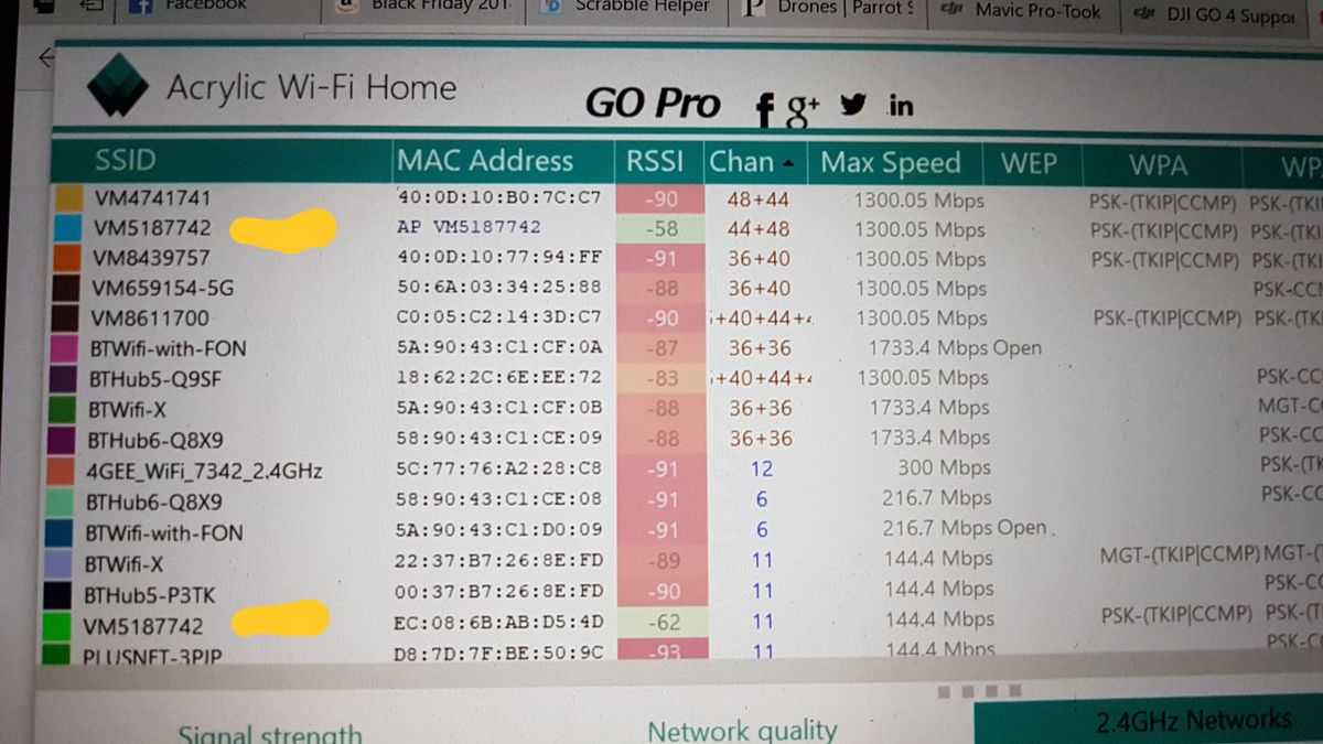

Thanks for the reply. Pls check the attached photo and advice me.photophoto

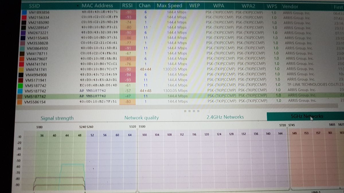

Include please a screenshot of the tab “AP channels in 2.4GHz” where the bottom graph is also visible.

2.4GHz2.4GHz
5GHz5GHz
 I hope this is what you asked for.

Thanks for uploading the screenshots. So as you clearly can see for yourself you are living in an extremely congested area. You can see that in the 2.4GHz band, channels 1, 6 and 11 are the most used channels. And your router is also among the devices using channel 11. Which is the reason why your wireless connection is suffering from the interference caused by all other devices in your vicinity.
I would suggest you contact VirginMedia and describe them the problem. Explain that you need to set your 2.4GHz band manually to channel 9 or 8. They should definitely have customer service assist you through the phone in order to get that done.
