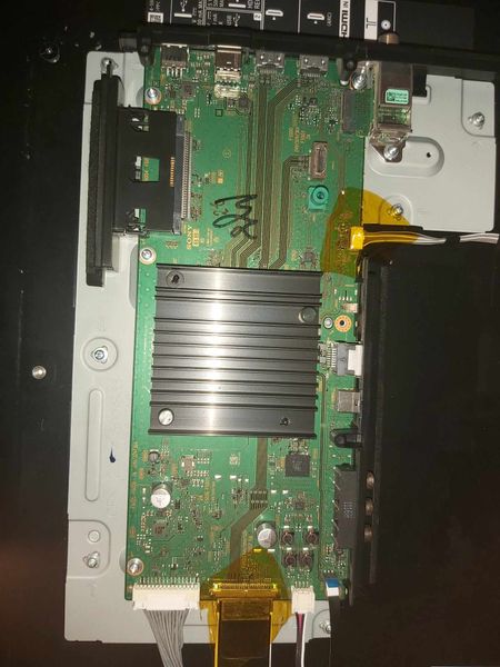

Hi, I just bought this TV and it's missing the power supply. Struggling to find out exactly what parts I need to order grr. Also the TV has been marked by someone with a cross inside a box in the second photo. What is in that area because that looks like someone's marked a fault to me. I appreciate any help. I'm from the UK.

Opened the back of the TV up to look at the area the x was marked but no idea if something is missing.
