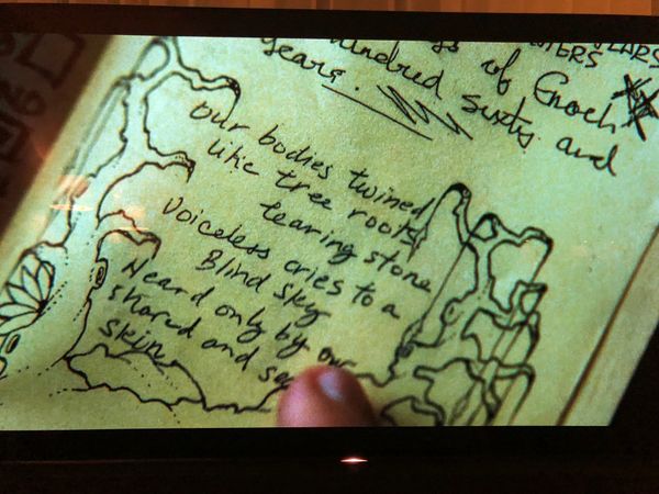

I have so far experienced that in certain scenarios the TV software erratically fails to identify DV content and thus apply the DV picture mode. This results in the TV falling back to the last picture mode in-use before the DV content playback. You can try to replicate this by pausing DV content on Netflix and entering the picture settings menu repetitively. In other scenarios, changing picture menu items while the DV picture mode is active and DV content is being played back can lead to corrupt image processing (see below images). You can try replicating this by toggling Adv. Contrast Enhancer between Off and High during DV playback.
Incorrupt Picture
Corrupt Picture
