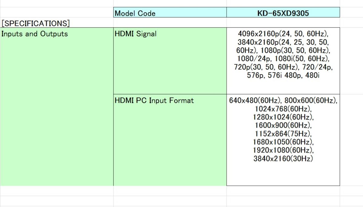

According to this Sony page the TV should support YCbCr 4:2:2 when using 3840 res, 60Hz and 10 or 12 bit colour. I have tested this extensively and my TV simply does not register any signal when trying any of these settings.
I also tested YCbCr 4:2:2 at 50Hz, still does not work. I have to go down to 30Hz to get it to work (most of the time, once it wasn't recognised and then the TV crashed) and it also works at 24Hz.

Unfortunately it doesn't make any difference, I can still only output at the same formats as before. I've been experimenting with a number of different colour formats, colour bit depths and refresh rates. The conclusion that I have come to is that my TV will only recognise the formats show in black on this Sony page. Clearly this is wrong, since my firmware is bang up to date so I should be able to use the formats shown in red as well.
Perhaps the updated firmware is not working properly with this model? I'd really like to hear from someone who has some of the signal formats in the red text in the link above working on an XD93...

Hi, my TV is the XD93 which is a 2016 model with a 10 bit panel. Its rated as being able to accept 4k 60Hz 4:2:2 at 12 bit over HDMI, as long as the firmware has been updated.
Basically, if you look at this webpage, my TV should support all of the formats in red but in reality will only accept the formats in black based on my current experimentation. Even forgetting about 10 bit or 12 bit, it won't even accept full RGB 4:4:4 at 4k 60Hz 8 bit as you mentioned you do with your model. That is only possible right now up to 30Hz.
